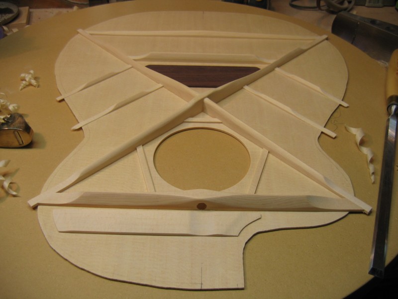

I have the largest curved bottom Ibex that Lee Valley sells, I think it is one size smaller than either Stew-Mac or LMI (can't remember which one) sells. I also use a 1/2" Sorby pairing chisel, also from Lee Valley. Some people here don't like the Sorby's, I like mine and have four of them, 1/4" to 1" but use the 1/2" most. Here is a pic of the tools and the results:
When I am shaping braces I put down two layers of low tack (the purple stuff from Canadian Tire) masking tape along each side of the brace and that offers lots of protection for me. I use the plane for rough shaping into a triangular form and finish off with the chisel, especially for the tight spots and then smooth it all off with sandpaper.
By the way, your top looks great!
